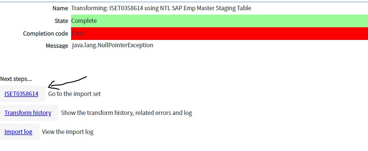

I am facing an issue in transform map and the issue is like while run transfer , error is showing as "java.lang.NullPointerException" .
For this i checked below
1> checked the mappings of source table and target table and the mapping is correct
2> in community i found that if date type of source table "basic data/time" then this error is showing but in staging table the date type is mentioned not "Basic data/time".
3> To check without date field and scripts , i removed these fields from mapping table and tried to run the transform map but still this error is showing , so could not understand what will be the issue here.
Need suggestion from you dear developers.
In transform history , shwoing as below
Manmath

08-19-2019 09:31 PM
Hi Ankur,
after removing date fields, script fields also the data is not transferring and the error is showing same
If i will click on this above highlighted importset then the error is showing as below
if i will click on this error , it is redirecting to an employee's record.
please give some suggestion if you find anything.
manmath

08-19-2019 09:50 PM
Hi Harshal,
Thanks for your response.
please give some suggestion if you find anything. and there are almost same 10 records in staging table.
manmath
