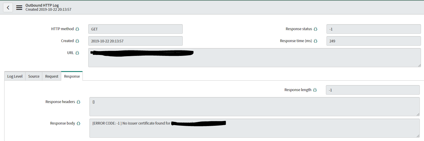

Receiving 'No issuer certificate found for' error when making outbound REST Message calls.
10-22-2019 09:11 PM
I have the external REST API providers SSL certificate loaded into the Certificates configuration section and validated successfully:
When attempting to run a test for the REST Message, I receive the following error:
Here's the entry from the Outbound HTTP Log:
Any help would be greatly appreciated.
Thanks.
10-24-2019 06:27 PM
Did some further SSL certificate validation via the following online tool.
Discovered that our Apache SSL configuration on our REST API server was not setup for our intermediate certificates.
Updated the configuration per these instructions, and now the REST Messages are testing successfully.
