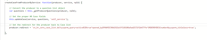

How can I redirect a record producer that is executed on native SN (when the record producer is accessed from a module URL link) to the newly created HR Case form after submission? Is there an option redirect to the newly created HR Case instead of modifying oob script include?
Script in Record producer:
new sn_hr_core.hr_ServicesUtil(current, gs).createCaseFromProducer(producer, cat_item.sys_id);
OOB script include is redirected to HR list view:
In the 'Record producer', the 'Redirect to' field is set to 'Generated task record'. However, after submitting, it redirects to the HR Case list view instead of the newly created record.
miro2
found simple solution, just put it in record producer script
producer.redirect = "sn_hr_core_case.do?sys_id=" + current.sys_id;
