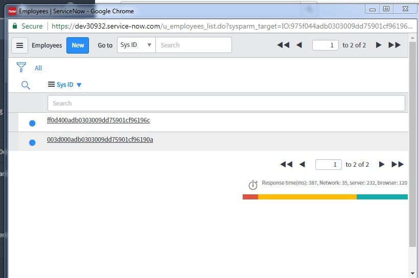

reference filed is showing sysid in popup
umesh_nagaraja
Pop up that opens from reference field is listing sys_id's even though the field on the table which is used in reference field has Display set.
Michael Fry1
Since it's the only column in your list view, it's going to show you the sys_id. Add another column and make it the first column

Deepak Kumar5
Open Pop- up, Click on list header and then Configure-->List Layout
Add your Field name right side then save.
