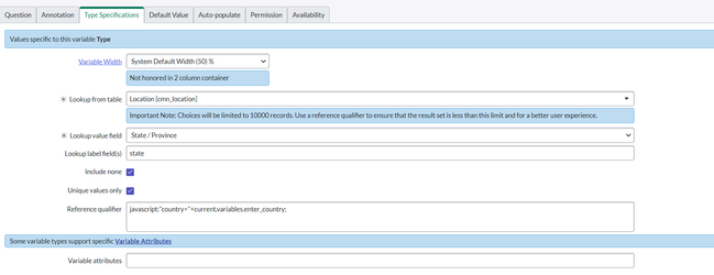

‎08-13-2024 02:29 AM
Hi @abhijee,
You may try with the following solution.
In reference qualifier instead of calling script you can directly write the
javascript:"country="+current.variables.enter_country; //here "enter_country" is backend name of my country lookup box.
Please mark my response as correct and helpful if it helped solved your question.

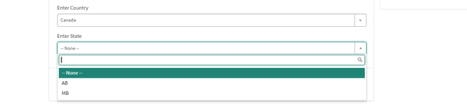

‎08-14-2024 01:38 AM
Hi @abhijee
Assuming you have two lookup select box variables for Country and State respectively, you need to make use of the below Advanced Reference Qualifier in the State field to populate State based on country :
javascript:"country="+current.variables.country.getDisplayValue(); //Assuming country is the name of the Country variable.
Output :
