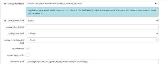

Trying to restrict 120 records not being available for selection for a field 'VM Name'(referencing to vmware_instance) and it has reference qualifier as shown below:
I have added the condition to restrict for 4 records using (isnot or isnot or isnot) line 6 but it is still not working, Script Include is below:

Hi Shidhi,
The one ting that I can see is that in your initial addEncodedQuery you have a lot of ORs around name.  If you have a device named VAARCPASH01, it will likely get included since that device passes the first test.  Have you tried changein gthose Ors to ANDs?

Hi @Shidhi,
I would recommend simplifying the query and testing one by one.
I can't comment if your query is correct or not, but I would recommend changing the following lines of script:
//var data = '';
var data = []; //change to array
//data += ci.sys_id + ',';
data.push(ci.getUniqueValue());
//return 'sys_idIN' + data;
return  'sys_idIN' + data.join(',');
