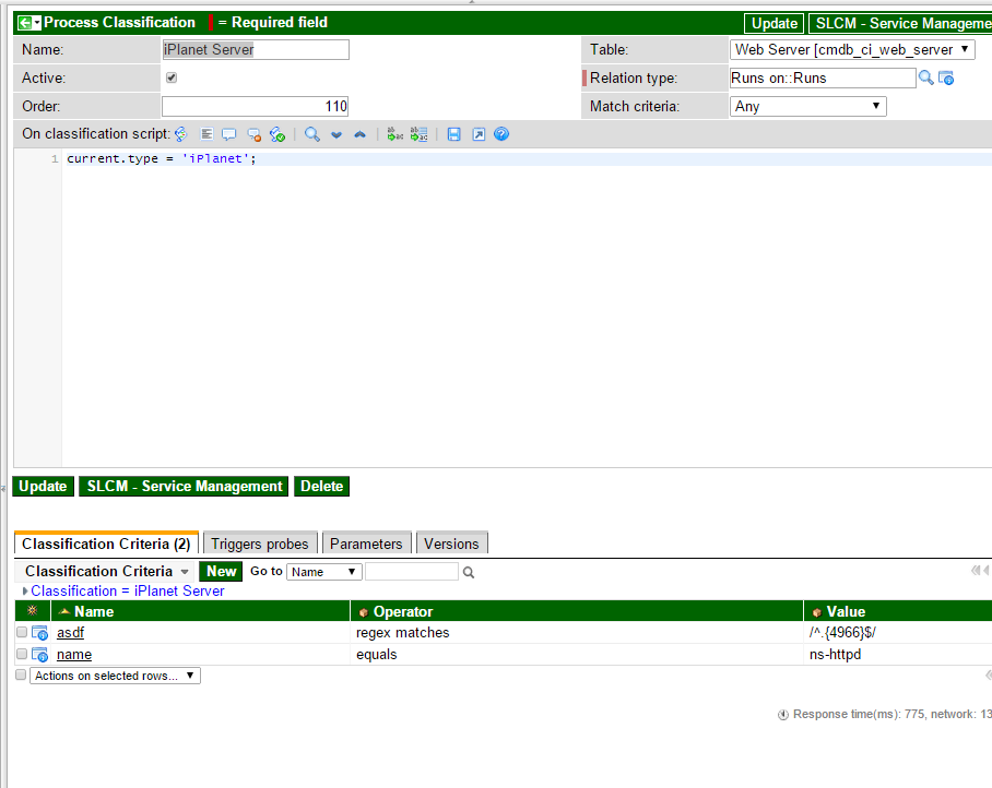

/^.{4966}$/
When this regex value is saved, it vanishes and a new condition is added:
I see this slightly differently to you - I am on calgary.
I have the classification Criteria tab at the bottom, and I can add it and it looks OK
