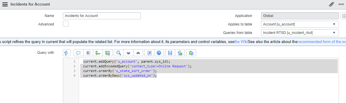

MG Casey
If you want a related list to always be sorted in a certain way, it's better to create a Relationship and use that as the related list instead.
https://docs.servicenow.com/bundle/jakarta-platform-user-interface/page/administer/form-administration/task/t_CreateDefinedRelatedLists.html
Example of one my Relationships I've set up with a default sort:
