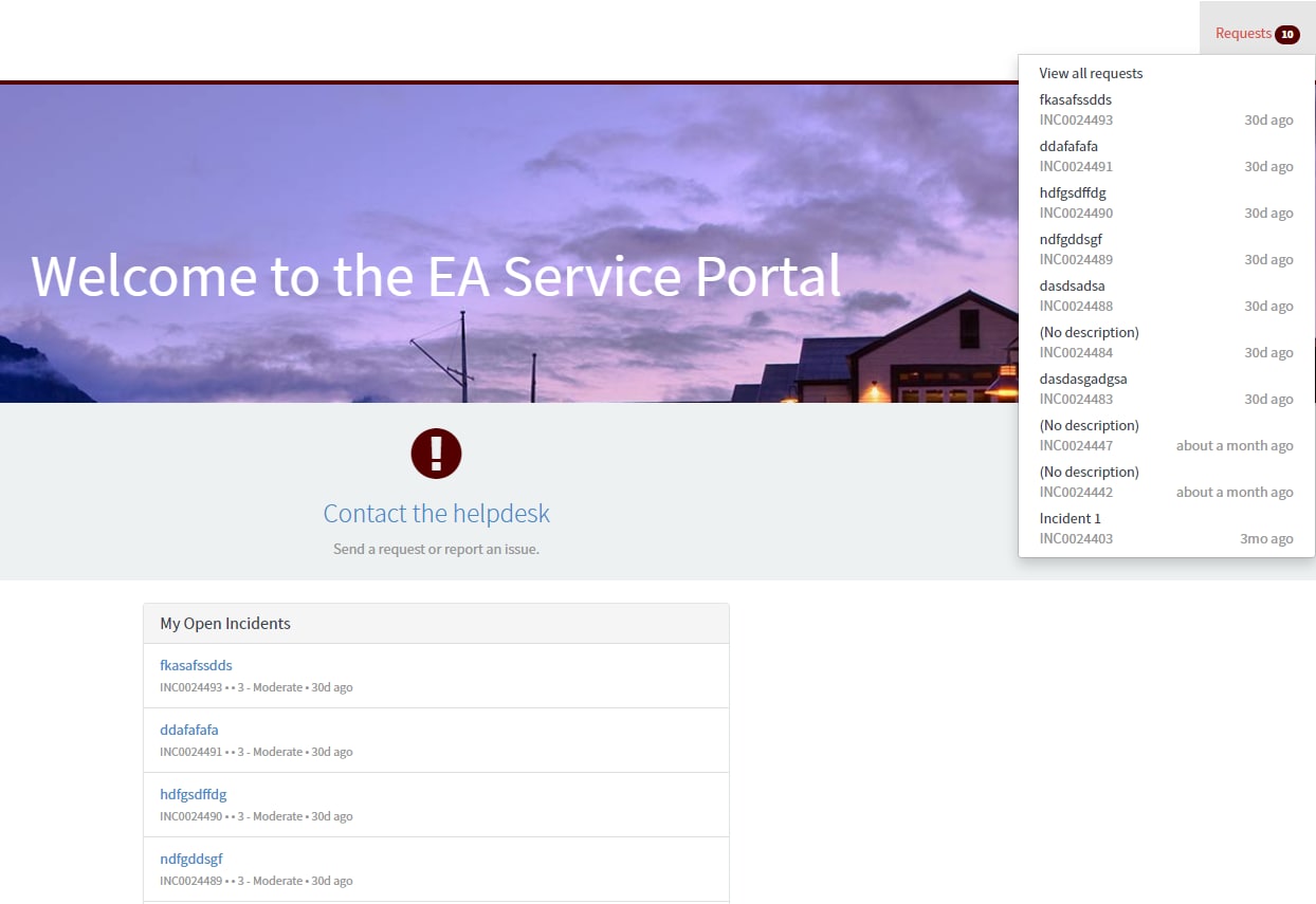

I have created a customised Header Menu that redirects to a customised ticket page when I click on the 'View all requests' link in the requests dropdown menu.find_real_file.png
 The redirect works but I am seeing the following error messages.
Does anyone know where I can go to fix these errors so that they do not appear when I select the 'View all requests' link?

DScroggins
Hi. The error is telling you that your widget 'EA My Requests' is referencing an invalid table name (ea_sc_request) on line 5 of the server code. Go to the widget and correct the code there. Hope this helps.
Vikas-Malhotra
Mega Guru
Please check the table name in your widget's server script. It seems that ea_sc_request is an invalid table name.
If you are using OOTB Service Catalog tables, then the table name should be sc_request.
