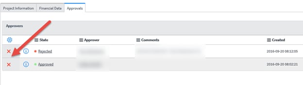

I am developing a custom application that requires approvals from people in my company. On one of the forms, I am displaying the approvers in a related list like so:
How do I go about removing and/or disabling the Red X to delete entries from the list?

‎09-20-2016 06:08 AM
Ensure they do not have delete access to the record.
FWIW, that's an embedded list, not a related list. Related lists are at the bottom of the form. You might consider using a related list in this situation (standard OOB functionality.)

‎09-20-2016 06:42 AM
Yes, modify the delete ACL. By default, the system creates four ACLs with the role you define on your table. Not always the best.
Best practice recommends that only admins have delete access on any tables. I commonly go through and update custom app ACLs to make sure admin is the only role allowed to delete and also review the write ACL.
If it's your app (scope) and your ACL, I have a hard time understanding why you cannot modify the ACL.
