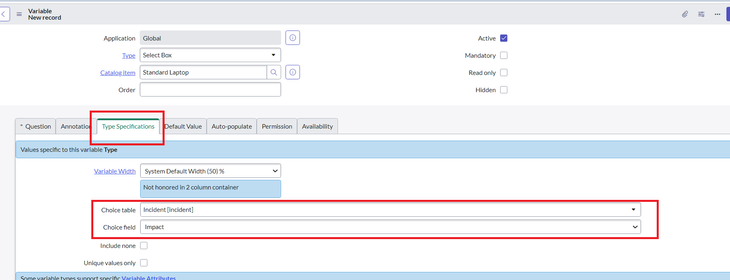

@Kiran Maruthi It is possible to show choice list of city field of table T1 in variable of record producer. You need to create "Select Box" type of variable. Then select T1 table in choice table field and "city" field in "Choice field" as shown below
If you want create any logic on record producer form on portal, then you need to explicitly create UI policy's and client script on record producer only.
