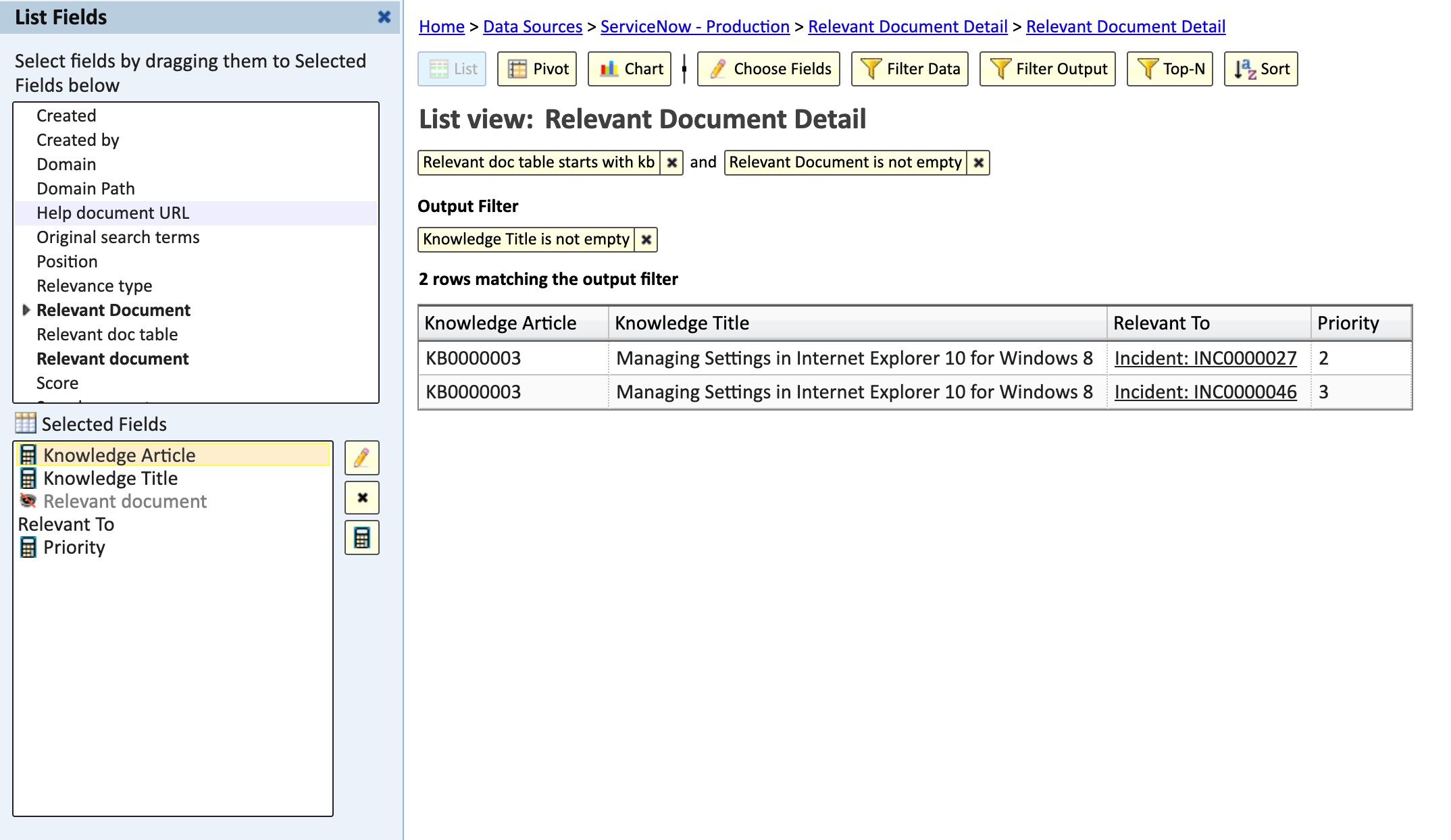

Allen is right about the cxs_relevant_doc_task table, although if you want the list grouped by the article you may want to look at the table cxs_rel_doc_detail, dot-walking to the parent "Relevant Document" table to get the "Relevant To" field.

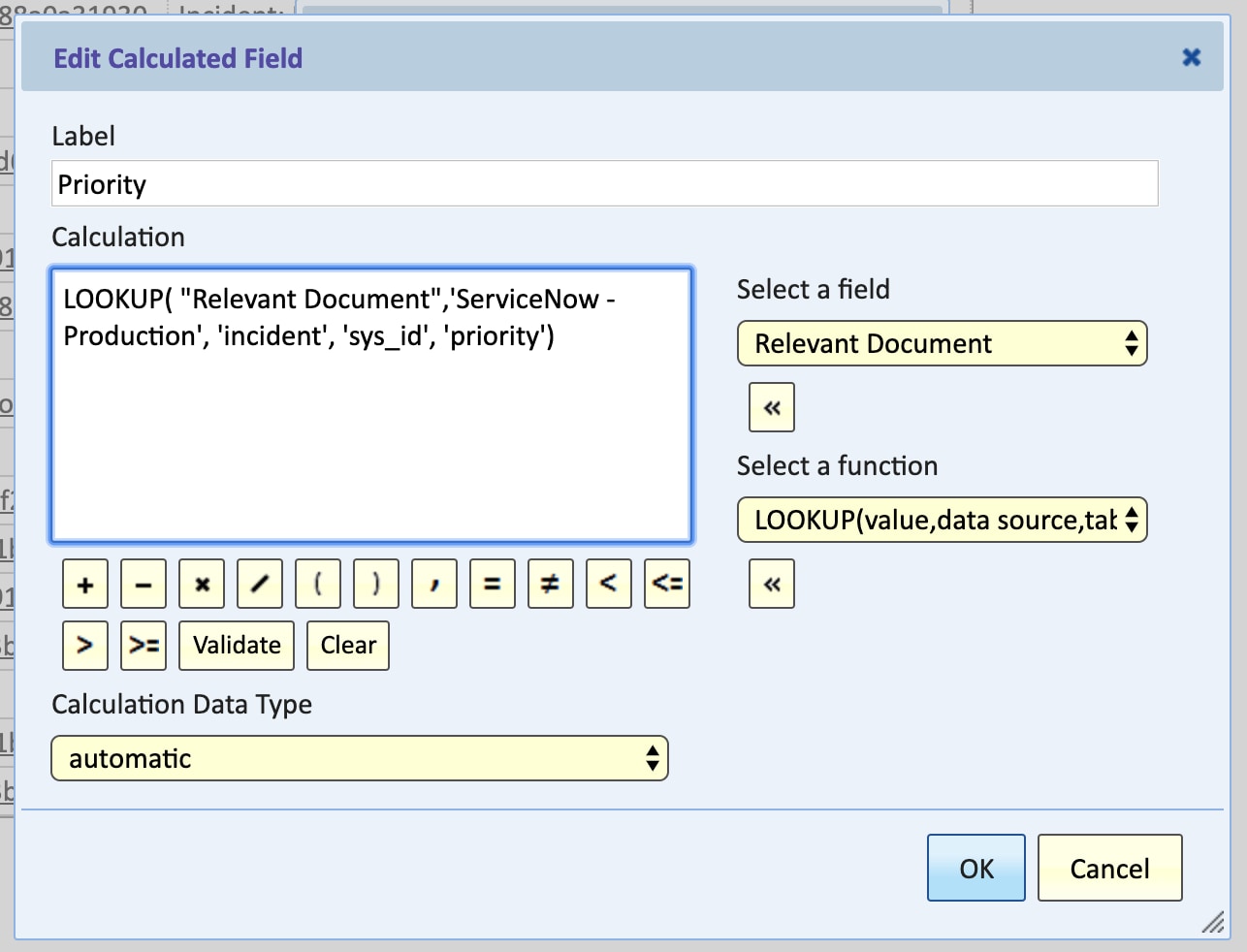

Unfortunately, there are some limitations because ServiceNow stores the "documents" as a document ID field, which ServiceNow can't dot-walk. I used Explore Analytics (a real-time integrated reporting tool) to use a "lookup" function to pull additional fields:
04-23-2019 06:34 AM
Nice. But they said they want to look at the incidents the articles are attached to. So in my method, they can group by the "Related to" field...which keeps the data together in their list.
So sort of the other way around than what you're talking about.
