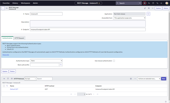

I completed the first step of creating the GET HTTPS in instance A, with the endpoint 'instanceB table API'. And the rest has me confused. Please be patient with me. 🙂
And here are my inquiries:
1) Should the endpoint of the POST https method be instance A's staging table? If no, how both POST and GET relate?
2) Is the scheduled job's script correct?
