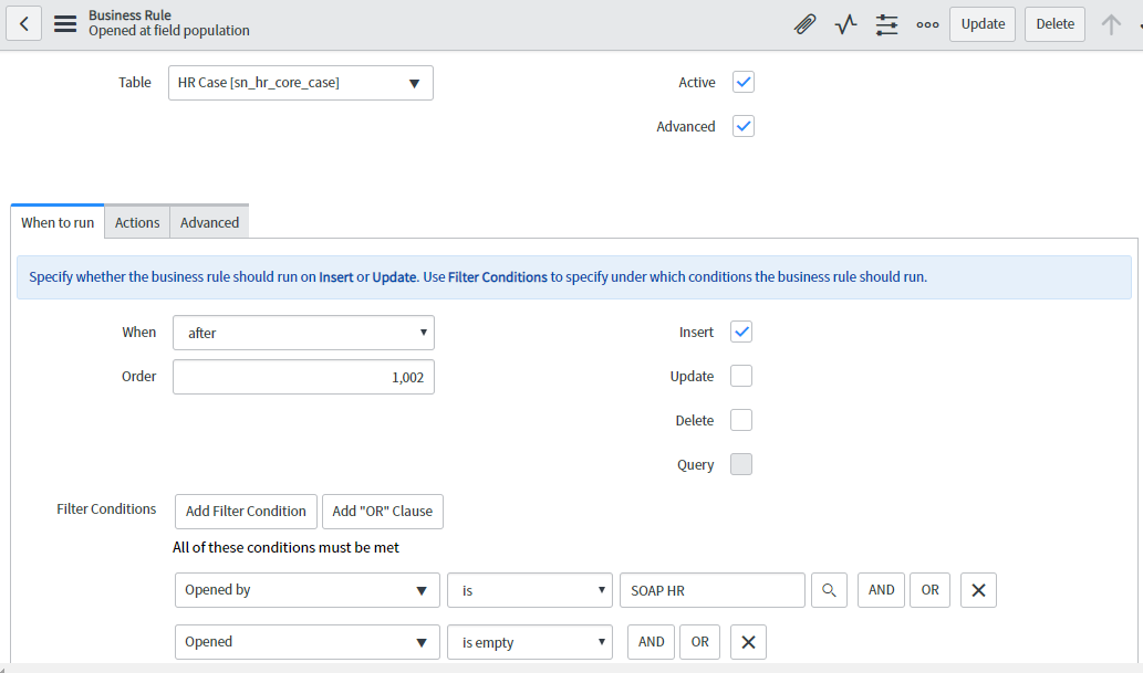

bala1992
Giga Contributor
Create a "after" business rules of the particular user and in script set opened_at field value from sys_created_on field value
