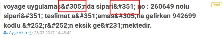

We have implemented an integration between Snow and third party supplier but when I send out short description information to third party, occurred Unicode character problem;
My business rule that trigger to third party system is here; also putting Http headers information . I tried everything I had but I couldn't replace this HTML characters. I need to replace "ı" to "ı" . How can I fix the problem guys? Thanks.

In the business rule, Does it work if you replace the all unicode characters in short description with ı?
var short = current.short_description.toString();
short = short.split('ı').join('ı');
r.setStringParameter('subject', short);

Thanks for your interest but it did not work.
It seem to have some relation with the language in which short description is entered. Please see if this it works when you encode the short description.
short = encodeURI(short);
