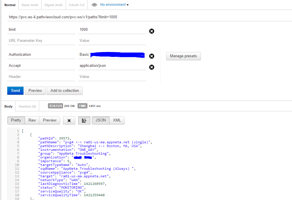

I am attempting to consume a 3rd party REST based API. I am able to consume it successfully via Postman in Chrome, however using the same headers I am receiving the following exception as a response in Service Now when executing a test: javax.net.ssl.SSLHandshakeException: Received fatal alert: handshake_failure. I've tried using both the Use basic auth option and a direct Authorization header approach via ServiceNow. Please see the screenshots below. Any advice/help with this issue would be much appreciated. Thanks!
Success:
Failure:
