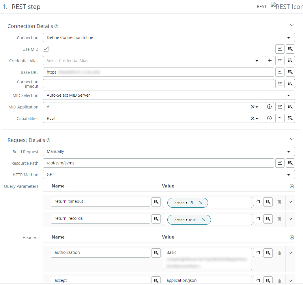

I've been trying to test a REST action and I'm fighting with a query parameter. When I run the call via curl I add 'return_records=true' after the path so that it returns some actual values and that works fine. In ServiceNow I'm adding that as a query parameter with return_records as the name and true as the value. When I test this it keeps inserting %EF%BB%BF after true which is screwing up the call. I've tried moving true into an input data pill as a string boolean but it still adds %EF%BB%BF.

Hey Tony, using Postman I get a 200 response code and returned json of the records that I'm looking for. It doesn't add that extra %EF%BB%BF after 'return_records=true' in the query. Below is a screengrab of what I've entered. The two data pills are just manually entered inputs with the one labeled 15 being an integer with value 15, and the one labeled true is a string boolean with value true. If I get rid of the data pills and just type the values in as strings it adds the %EF%BB%BF after both so it appears to not like strings.

Also another note for anyone that ends up here with similar issues. A normal string variable seems to always end up with extra hex junk in the output path/url. If you use a String (Full UTF-8) variable it seems to work just fine.
It's still kinda stupid and non-obvious. Maybe this is all fixed in the next update but working in San Diego it still feels a bit half baked. It seems like all the pros ignore this method and just do everything via javascript which I get, but my javascript skills are noobish and there is a section for queries so why struggle...but then it's not obvious so the struggle exists anyway. Hope this helps someone.
