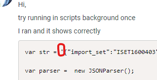

Few questions. From what you shared earlier you created the "str" object with this data that included the outermost notation marks;
However, when I look at the Response Body in my Outbound HTTP Log that isn't there;
So, if I'm not mistaken when my "var response = request.execute();" completes then I'm left with this;
var response = {"import_set":"ISET4030016","staging_table":"u_test_request","result":[{"transform_map":"Test Transform","table":"sc_req_item","status":"error","error_message":"Target record not found","status_message":"Order Placed;Row transform ignored by onBefore script","test_sys_id":"3cc1848a07e2761445600e9137a4b0f8","test_display_value":"TEST0235522"}]}
Is that correct? If so I've already taken these steps to ADD the ' marks and it works in the Scripts-Background but still not working in the System Logs.
