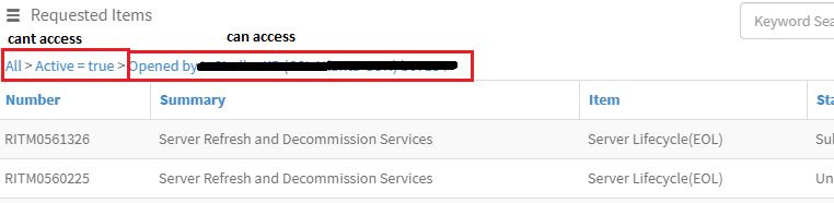

Fixed!!
Guys I tried all possible ways to get a restricted filter for tables in portal, Nothing worked for me.
Finally I fixed it with the help of css.
I just copied selectors of each breadcrumb <a> tag from instance element and written below script in page- css not in widget-css.
.v339a5c41d7201200b0b044580e61030d .breadcrumbs span:nth-child(2) a ,
.v339a5c41d7201200b0b044580e61030d .breadcrumbs span:nth-child(3) a,
.v339a5c41d7201200b0b044580e61030d .breadcrumbs span:nth-child(4) > a.sp-breadcrumb-link.sp-breadcrumb-remove-condition.ng-scope{
pointer-events:none !important;
Now its perfect and user can able to access only last filter option in breadcrumb.
