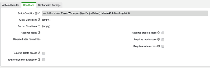

Is there a way to restrict the visibility of the "new" button?
In my case only admin should see it.

Hi @PetarK ,
Navigate to sys_declarative_action_assignment.LIST,
Now filter with Action Label = New and Table = pm_project.
Open the record and from the related links click Advance view.
-----------.service-now.com/nav_to.do?uri=sys_declarative_action_assignment.do?sys_id=d1ff82f277ea42107f9578847a5a9962%26sysparm_view=advanced
You get a Conditions section, which has Required roles.
Add the roles you need.

12-02-2024 10:41 AM
Is it similar for this button as well ?
