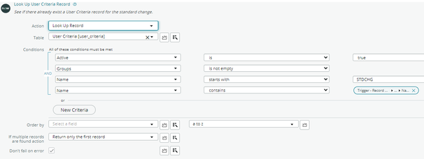

- I then looked up the User Criteria (UC) (user_criteria) to see if there is an existing entry for the catalog item (sanity check). It should not find one, but 90% of code is for the stuff that never happens.
- If the UC does not exist it will create one

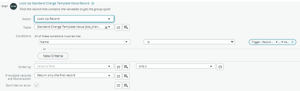

- Needed to get the group from the Standard Change Template Value table, this is where the values are stored.

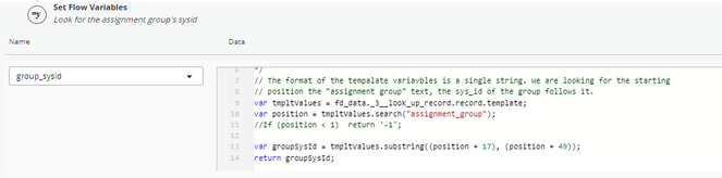

- Once I have the record, I set a flow variable with the sys_id of the group I want to limit the catalog item to. Script I used to set flow variable:// The format of the template variables is a single string. We are looking for the starting// position the "assignment group" text, the sys_id of the group follows it.var tmpltValues = fd_data._3__look_up_record.record.template;var position = tmpltValues.search("assignment_group");var groupSysId = tmpltValues.substring((position + 17), (position + 49));return groupSysId;

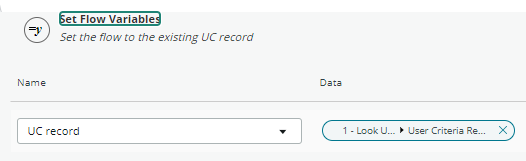

- If the UC was found I set the same flow variable as used in Step 5, only difference is that I set it to the UC record that was found.

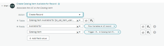

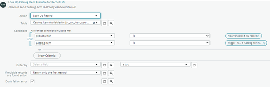

- I then look up the Catalog Available for
- If the Catalog Available for is not found create a record, if found do nothing.
Here is screenshot of the flow:
This sets the User Criteria on the Catalog item to use the User Criteria that has just the group in it. Users that go to the service catalog can only see the item if they are a member of the group.
