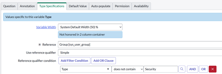

To confirm, the "Type" field on the sys_user_group table is = Security? Why can't you make that your filter?

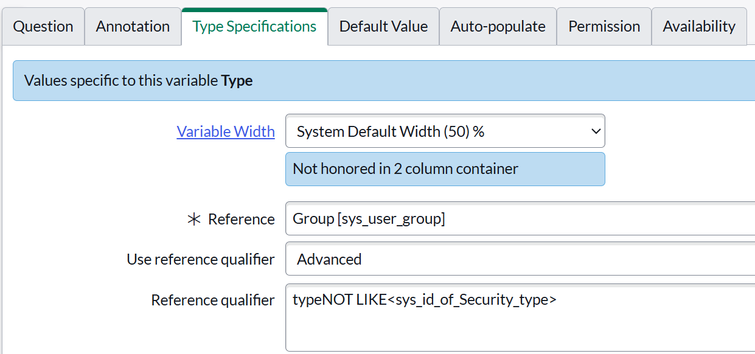

Another option (you really wouldn't need to do this when you can do the above) is to switch this to an Advanced reference qualifier and paste in the query there (to do this, I went to sys_user_group.list and built my filter, and copied it):

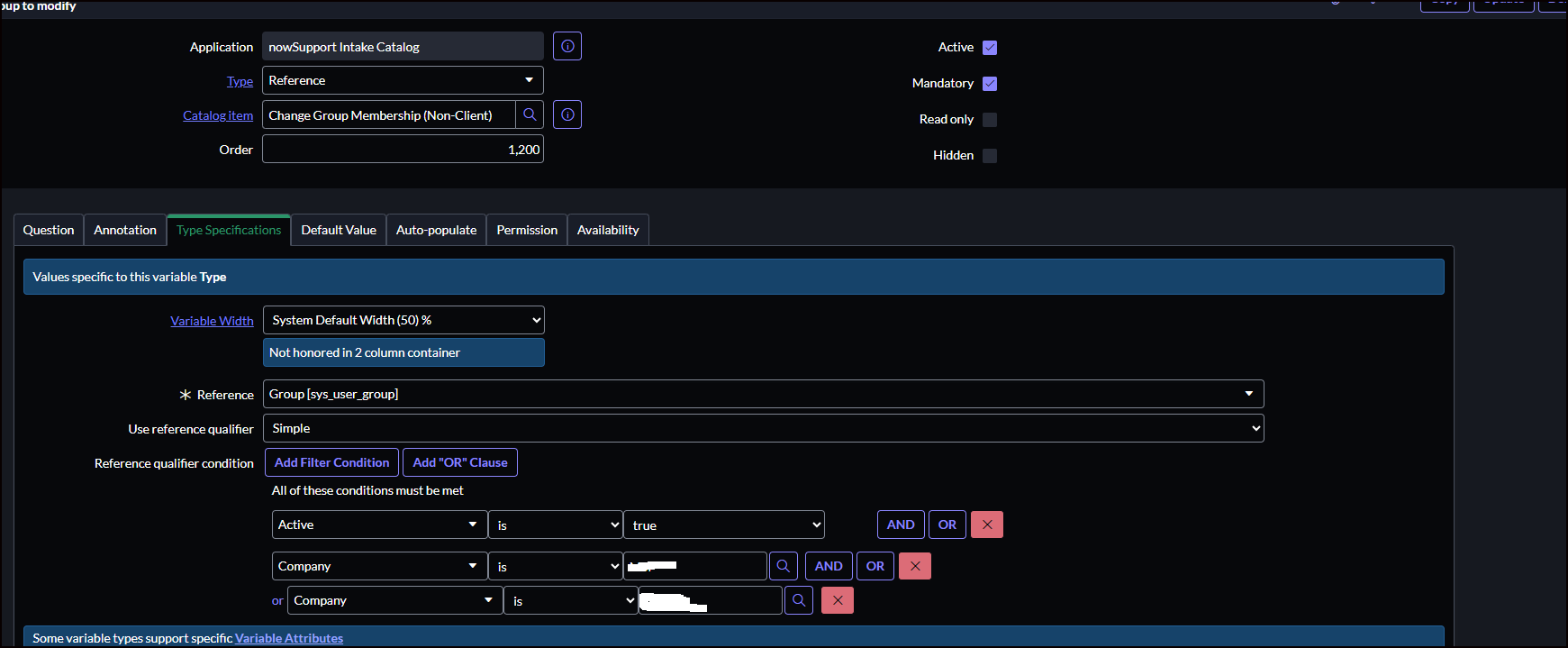

Thanks for the reply!  The reason that I didn't use a filter of 'type' was because we have multiple security type groups but I just needed to filter out 3 because they have 'elevated' permissions.  I did try using the advanced filter with sys_id for those 3 but for some reason it isn't working.  I will continue to investigate.
You could also try filtering based on the name of the group or another characteristic. If you want to share your filter, I'm happy to help troubleshoot!
