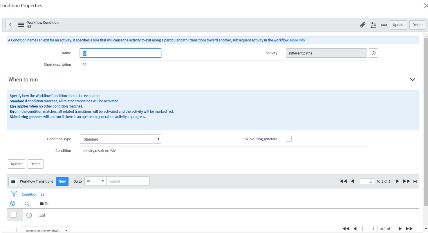

On the sc_task table, field 'state' add new states according to your needs. (I guess you can you some script later on to hide these states from the list for other tasks).
So I have new state - 58, i didn't bother to create all three.
Now there is a script include 'TaskStateUtil'. On line 27 you should include all your newly created states. This way the the task will become active = false, when you will select any of these states. It is necessary as workflow waits until task becomes inactive.
Now there is a business rule SNC - Run parent workflows. You need add your new states to conditions:
I have created UI actions on sc_task to set the state as needed. You could probably add some conditions to show these UI actions to certain users who will be handling these tasks.
I have this simple workflow:
And condition '58' looks like this:
And this is the result, workflow moves forward and new task is created.
Well it looks pretty ugly, but it works. I didn't do any other testing, so its on you how it will affect other functionality of sc_task and related items.

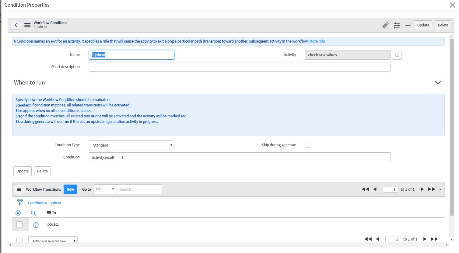

lukasrudaitis
Ok, it seems I went too deep and focused too much to make it work on catalog task activity..
Workflow:
Run script after the task is closed complete:
Add workflow conditions on 'run script' activity.
Result:
