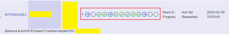

We have an odd situation wherein in RITM table we have the same record but the stages shown are inconsistent.
If we set filters on RITM table; show records with a specific catalog item and state is in Work In Progress, the filter would return a record that shows like this. a record with multiple stages showing and some are already marked completed. But in reality the flow for this record hasn't started yet, no tasks has been completed yet.

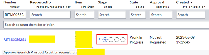

However, if you search the record just by RITM number (no other filters). The record would show up correctly; with stages not yet started and no additional stages.
This is how it should appear even on a list with additional filters.

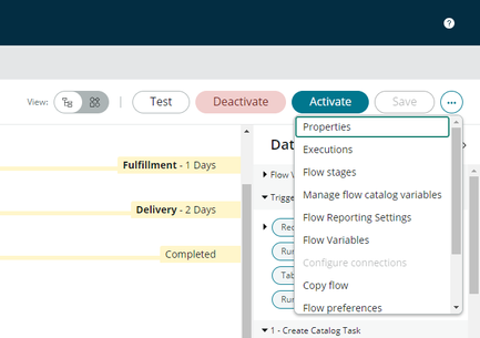

Click on more options (...) of flow and open flow stages, then arrange sequential stages in the flow stages and save.
Please refer blow screenshot:
