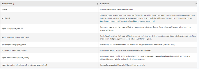

I have a query related to reports. If a user only have knowledge manager role, will it be able to share any reports to any user/group?. Also what all are the roles required to share reports to anyone in servicenow?

Hi @Ajith A Pillai ,
These are the roles available in servicenow related to reports,
To Share Report you can give report_group role to user
Please mark this comment as Correct Answer/Helpful if it helped you.

Hello Ajith,
In order to be able to share the reports with Users/Groups, "report_group" role needs to provided to the user.
You can refer the below article for the same:
Please mark my response as Correct Answer/Helpful if it helps.
Please see the different report roles here:
best regards
