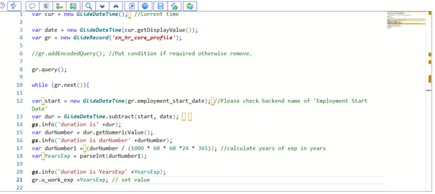

abirakundu23
Hi @Priya14 ,
Please try below code.
Please mark helpful & accept answer if it's really worthy for you.
