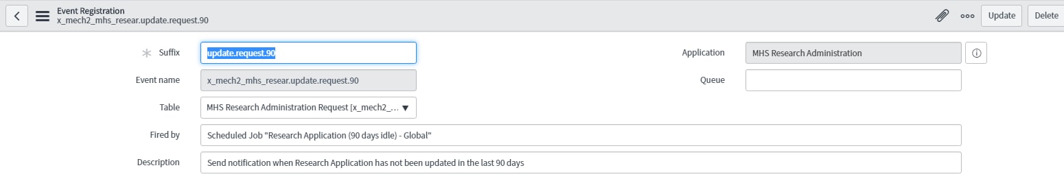

I created a scheduled job to trigger an event and notification.   The event and notification are in the scoped app, but the scheduled job is global (tried it in the scoped app, the event didn't trigger).   Anyway, the event is getting triggered, and notification is getting sent, but, on the scheduled job, I added a line to update the work notes, and that's not happening.
Here's the scheduled job:
Here's the event:
