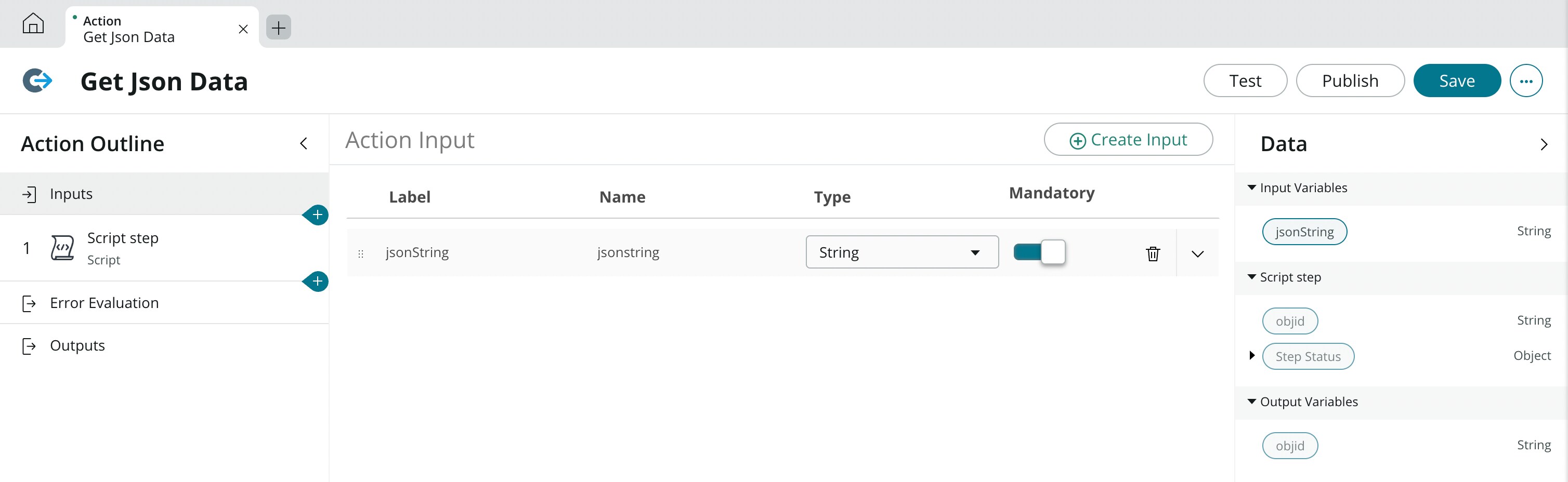

I created a custom action for this. Please look over how it is working. You will need to provide the JSON string
{"version":"21.4.73","treesize":1,"devices":[{"objid":12783,"objid_raw":12783,"status":"Up","status_raw":3,"name":"addc.com","name_raw":"addc.com"}]}
as an input, from whichever data pill is storing it. In my example, I am just passing it in via manual input for testing.
Inputs: For you this will be the data pill that contains the JSON response
Script step:
Takes the JSON string, parses it into a JSON object.
Assigns outputs.objid to the objid property in the JSON obj.
Outputs: Return the objid that we retrieved in the script step to the main flow.
Testing action - passing in the JSON string (response)
Result: objid is 12783
