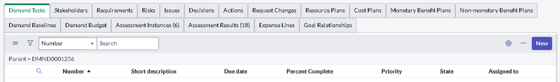

I'm looking for a solution to accomplish some requirements customer has asked me for. They want to block demand items edition according next conditions:
  • Admin, PPS_Admin, Members of assigned group (in the demand, not in the item) and assigned demand manager, can create or edit demand items (task, RIDAC, etc)
  • Any another user can't edit or create this items
let's take demand task as an example. I would like to hide/show 'New' buttón to meet the goal. I thought that modifying the existing ACLs with an script would do it...

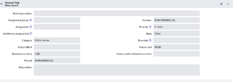

...and it works. If any user who does not comply with the permissions will try to create a demand task would not be able to submit the demand task. You can see:
Ok this solution will work but the problem is, as a mentioned above, I would like meet the goal directly hiding/showing the 'New' button and with the ACL I can't do it.

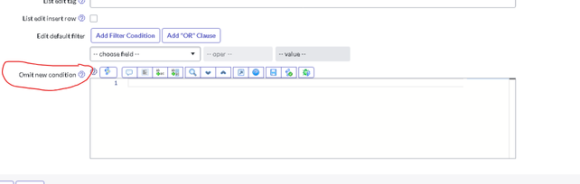

I have tried with script in 'omit new condition' in list controls but I haven't had good results 😞

Hi @Leonel Sandroni
You should be using omit new condition for showing/hiding new button on related list
You can use below script for it (modify roles and field names wherever required)
var currentUser = gs.getUser(); // Get the current user
var isAllowed = false; // Initialize the flag for permission
if (currentUser.hasRole('admin') || currentUser.hasRole('PPS_Admin')) {
    isAllowed = true;
} else {
    // Get the assigned group from the Demand form (assuming it's stored in a field called 'assigned_group')
    var assignedGroup = parent.assigned_group;
    if (assignedGroup && currentUser.isMemberOf(assignedGroup)) {
        isAllowed = true;
    // Get the assigned demand manager from the Demand form (assuming it's stored in a field called 'demand_manager')
    var demandManager = parent.demand_manager;
    if (demandManager && currentUser.getID() === demandManager) {
        isAllowed = true;
isAllowed;
