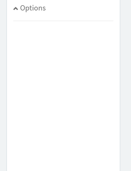

thanks for the suggestion.  I tried adding that to my script...it appeared to fill the widget with blank space...so something was there.  When I logged "array" to the console, it did list the entire list of all the variables from the catalog item...however it included all variables, including formatters...and it did not log the variable values.  I played with it a bit and could not get it to only show the variables that presented fields on the catalog item and their values.  Here's what the "Options" sectin showed in the widget.  And below is the script I tried last.  any thoughts?

Hi Ankur,
that script is setting "array" to just the variables with values, so that's good.  However it's not setting the variable values and it's not showing either in the widget.  It's taking up the space in the widget, but not showing anything.  Anything else I can try?
