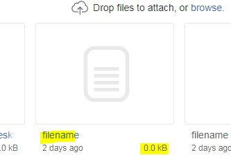

Hi neeraj_sharma,
I managed to create the attachment in Jira.
but.. not quite
it creates with 0.0kb file size.. so guessing the encoding is wrong and obviously the file is corrupt.
this is my code:
createAttachment : function( attachment_sys_id, key ){
var attachmentMessage = new sn_ws.RESTMessageV2('JIra Issue Attachment', 'post');
attachmentMessage.setBasicAuth(gs.getProperty('com.snc.integration.jira.jira_api_user'), gs.getProperty('com.snc.integration.jira.jira_api_password'));
var attachmentRec = new GlideRecord("sys_attachment");
if (attachmentRec.get(attachment_sys_id)) {
attachmentMessage.setRequestHeader("Accept", "application/json");
attachmentMessage.setRequestHeader("Content-Type","multipart/form-data; boundary=IDSNOW"+attachment_sys_id);
attachmentMessage.setRequestHeader("X-Atlassian-Token", "nocheck");
attachmentMessage.setRequestBody("--IDSNOW"+attachment_sys_id+"\r\n"+
"Content-Disposition: form-data; name=\"file\"; filename=\""+attachmentRec.file_name+"\"\r\n"+
"Content-Type: application/octet-stream\r\n"+
"Content-Transfer-Encoding: base64\r\n\r\n"+
"dIMVGkUy5ntp7q7VNj/luw=="+"\r\n"+"--IDSNOW"+attachment_sys_id+"--");
attachmentMessage.setStringParameter('base_url', gs.getProperty('com.snc.integration.jira.base_jira_instance_url'));
attachmentMessage.setStringParameter("issueKey", key);
gs.log(attachmentMessage.getRequestBody());
var res = this._submitBodyTypeRequest(attachmentMessage, true);
return res;
and it creates:
How can I solve this?
Pedro

Hi Pedro,
Currently we are integrating servicenow with Jira application and right now I am facing similar issue like you.
file which is transferring from servicenow to Jira is successfully transferring but file size is 0 and it doesn't have content in it.
could you please help me on this, you help will be appreciated.
