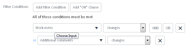

what are the conditions on the business rule?
Hi Abhinay,
The conditions on the business rules are as follows:
Karan
