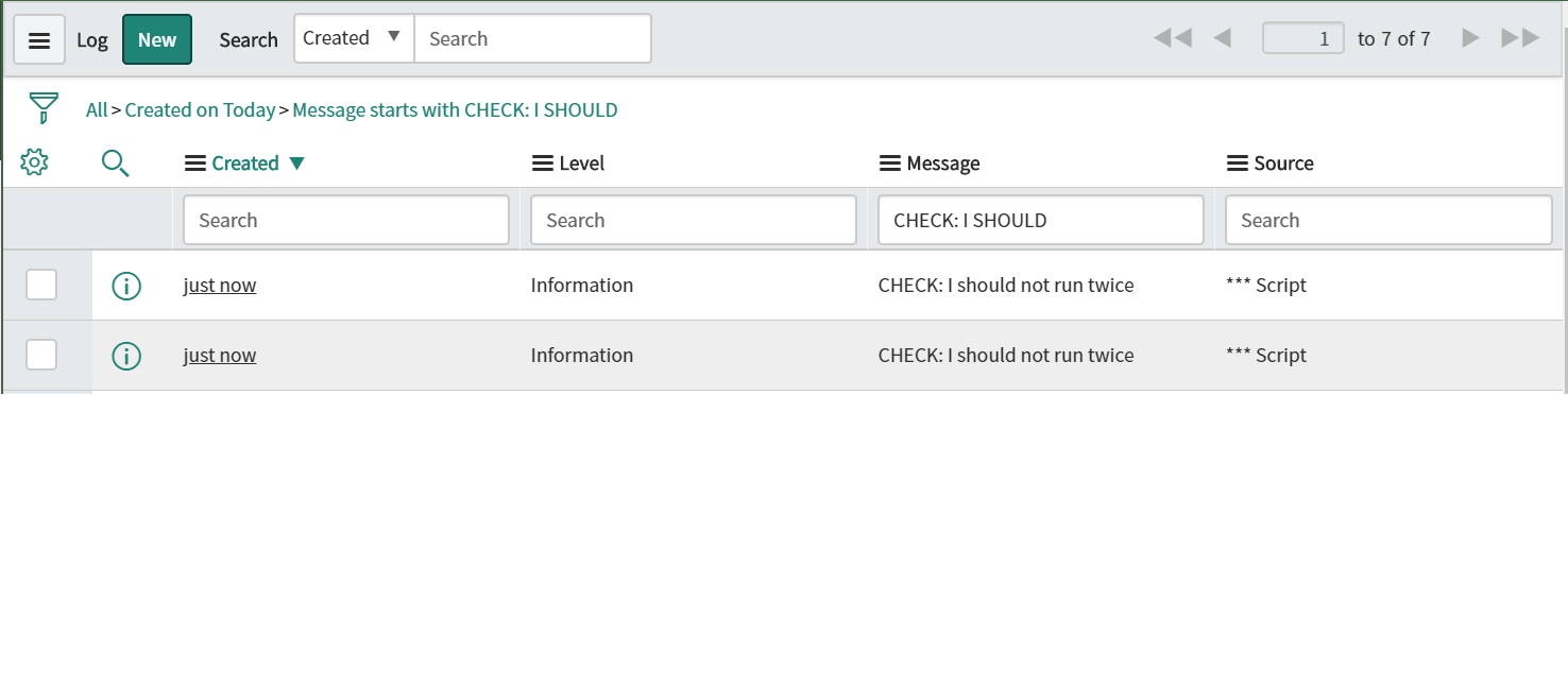

But if I instead use ng-init="c.onLoad()" or some other AngualrJS directive that calls the onLoad function, the client script appears to run once but the server script runs twice! I was able to verify this with the client and server logs.
I don't see why using the angular directive causes the server script to run twice? Maybe somehow the controller is running twice?

08-05-2019 08:29 AM
Maybe but here's what's interesting: I just commented out the entire client script and the server script is still running when the page loads for some reason. Maybe this isn't angular related?
08-05-2019 08:35 AM
Oh yeah, I guess that may be the case. But is there any way to prevent the script from running on load? SN seems to encourage this format as the default?
