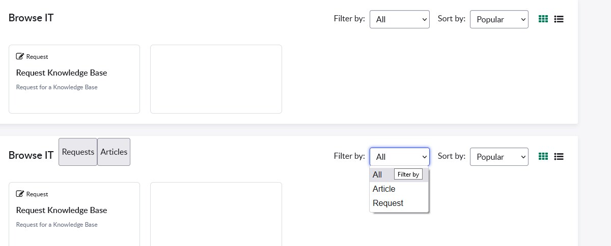

Hi. The current OOB widget Topic Content has an input dropdown field with "All", "Articles", "Requests".
I was trying to change the code on the widget but all of the code is based on the input selection and I am very new to Angular, directives, etc.
What would be the best approach? Instead of the dropdown selection, the idea is to click on the Request button and refresh the widget with catalog itens. Same thing for the Request button.

First of all, thank you so much for your response, I really appreciate it.
The client wast a very custom portal, I know OOB is the best approach, but its too late for that.
Do you know where can I get like a basic guide in how to start learning Angular and Portal Widgets?
Ill try something out based on the input you provided.
Again, thanks a lot.

Its working now. I just changed one line. Thank you so much.
From:
$scope.getMyNewUpdatedContent = function(filter_sys_id) {
        c.data.action = filter_sys_id;
        $scope.updateContent();
To:
        c.data.filterBy=filter_sys_id;
