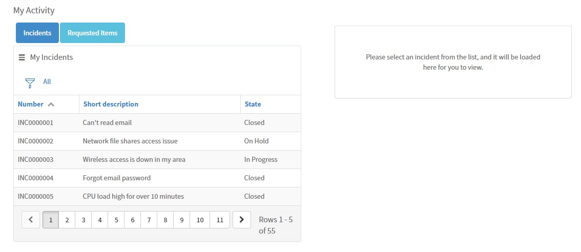

I've been working on a space-saving customization to the "Data Table from Instance Definition" widget.
Basically, I want users to be able to click a button and be able to choose which list they see, as well as be able to click an item on the list and have it load on the form widget on the same page.
I have that part working, using $broadcast to send events and pass information between the various widgets, see below:
What I haven't been able to figure out is how to get the Filter to respond. I've been through all the nested widgets, replaced them with custom ones, and passed every variable i can think of to every place i can think of, and no luck. The best I can figure, the filter widget (which is another embedded widget) isn't being reset when everything else is. Either that or theirs some piece of data I'm not passing.
Anyone have any ideas?

Nathan,
Thanks! That part is working. It's the embedded filter widget that isn't. When the page loads, the list is drawn from the incident table, and the fields to choose in the filter load fine:
But when  I switch it to the Requested Item table, it won't load anything but "keywords":

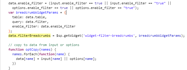

I think I've found the code responsible in the Server Script for the data table widget:
I have set the values for data.table, and data.filter, but I can't seem to get the widget to actually use them. I've dumped $scope to console both when it's working and not, and compared the structure of the relevant parts, and they seem identical (except for table names, of course) so I'm not sure what I'm doing wrong.
