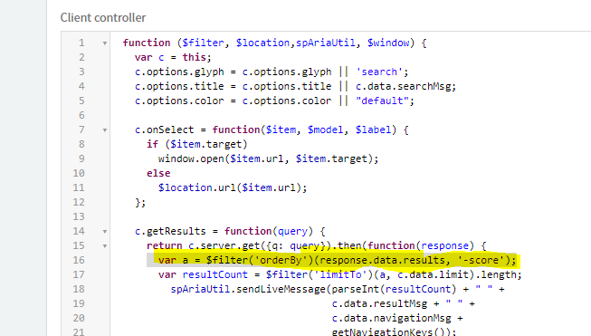

I have created 4 Search Sources for my Service Portal. I have set their ORDER so that the Service Catalog results will be the one to display first. This is working on the Search result page, however I would like to be able to display same order at typeahead in Search box. Has anyone came across such requirement before?

This is due to below line of code in 'Typeahead Search' Widget. You need to clone the existing widget and comment out the instruction/order by another field.

Gurpreet07
