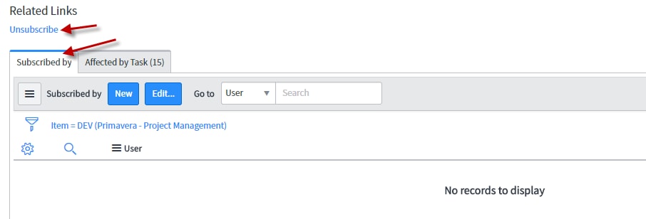

I trying to understand what the 'Subscribe' UI action in a CI does and how it differs from the 'Subscribed by' that can be added on a CI under 'Related Lists':
Clicking the 'Subscribe' link adds a does not add as Notification Subscription in table sys_notif_subscription and adding a user under 'Subscribed by' using the Edit button adds the user in table cmdb_subscriber.
