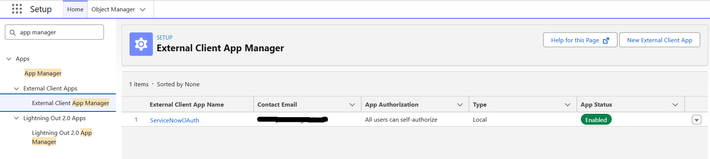

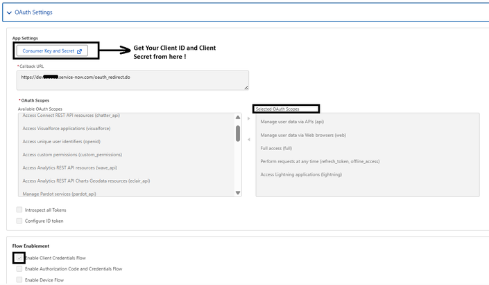

Salesforce Setup : Create an External Client App
Go to: Setup → App Manager → External Client Apps → External Client App Manager → New External Client App
- Name the app and enable OAuth settings.
- Under OAuth Scopes, select permissions like Full access or API access.
Note : Salesforce will generate a Client ID and Client Secret, which we will use to authenticate ServiceNow.🔑

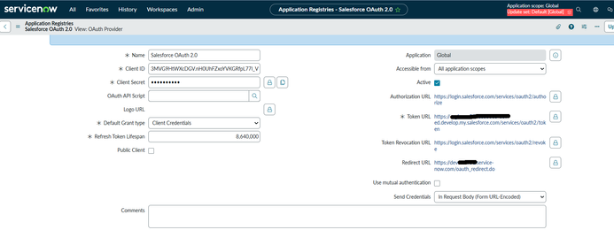

1. Application Registry (OAuth Provider) :
System OAuth → Application Registries → New → Connect to a third party OAuth Provider
| Field | Value |
| Name | e.g. Salesforce OAuth 2.0 |
| Client ID | Consumer Key from Salesforce |
| Client Secret | Consumer Secret from Salesforce |
| Grant type | Client Credentials |
| Token URL | https://<your-domain>/services/oauth2/token |
| Authorization URL | https://<your-domain>/services/oauth2/authorize |
| Active | ✔️ |

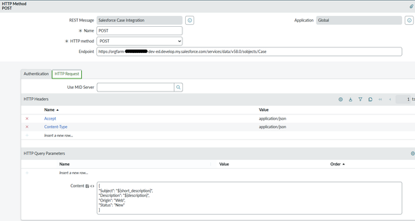

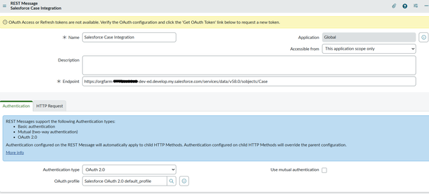

2. REST Message :
System Web Services → REST Message → New
| Field | Value |
| Name | e.g. Salesforce Case Integration |
| Endpoint | https://<salesforce-instance>/services/data/v58.0/sobjects/Case |
| Authentication type | OAuth 2.0 |
| OAuth profile | <created_above> |
Implementing Business Rule for dynamic creation :
- Create a Business Rule in ServiceNow that triggers on Incident creation.
- Call the Outbound REST Message in the Business Rule to send the incident data to Salesforce and create the case.
- Capture the Case ID from the response and update the Incident record with this ID.
Script :
// Add your code here
try {
var r = new sn_ws.RESTMessageV2('Salesforce Case Integration', 'POST');
r.setStringParameterNoEscape('description', current.description);
r.setStringParameterNoEscape('short_description', current.short_description);
//override authentication profile
//authentication type ='basic'/ 'oauth2'
//r.setAuthenticationProfile(authentication type, profile name);
//set a MID server name if one wants to run the message on MID
//r.setMIDServer('MY_MID_SERVER');
//if the message is configured to communicate through ECC queue, either
//by setting a MID server or calling executeAsync, one needs to set skip_sensor
//to true. Otherwise, one may get an intermittent error that the response body is null
//r.setEccParameter('skip_sensor', true);
var response = r.execute();
var responseBody = response.getBody();
var httpStatus = response.getStatusCode();
} catch (ex) {
var message = ex.message;
})(current, previous);

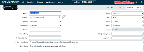

Testing the Integration :
- Create an incident in ServiceNow.
- The Business Rule will trigger, calling the REST Message to Salesforce.

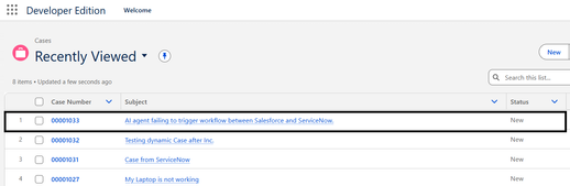

- Same way create an User in ServiceNow.
- In Salesforce respective acoount will be created.
