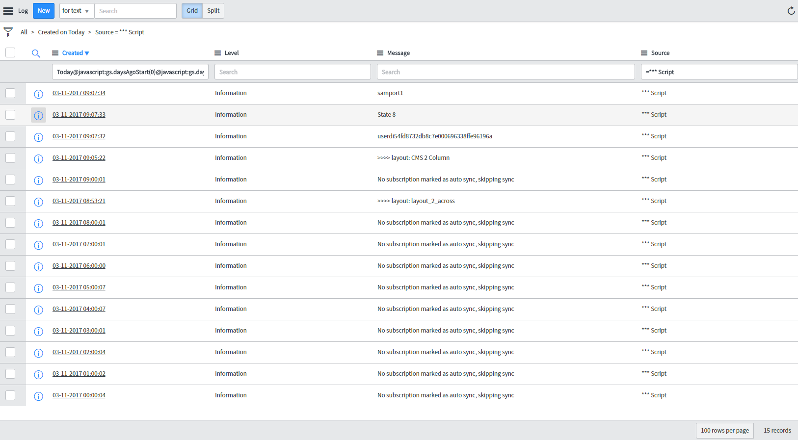

I've added the line to the end of the script, and checked in 'script log statements', but I am not seeing anything:
Sam
Sam this means that the gs.log script row is not processed. I suggest you to add various 'gs.log' in your code in order to identify where the error is located.
