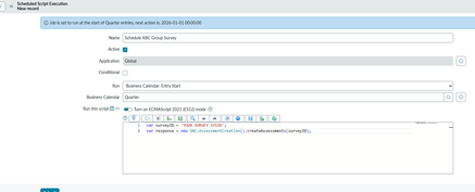

Hi @kim-lindgren,
To trigger a survey on a quarterly basis, you can use a Scheduled Script Execution instead of relying on Survey trigger conditions or the limited Schedule Period options.
Steps
  1. Navigate to System Definition > Scheduled Jobs.
  2. Click New.
  3. On the “What would you like to automate?” page, select Automatically run a script of your choosing.
  4. Fill out the form:
    • Name: Schedule ABC Group Survey
    • Run: Business Calendar: Entry Start
    • Business Calendar: Quarter
    • In the Run this script field, enter:
var surveyID = 'YOUR SURVEY SYSID';
var response = new SNC.AssessmentCreation().createAssessments(surveyID);
This scheduled job will generate and send the survey invitations every quarter, bypassing the limitations of the Survey Definition's built-in scheduling options.
If my response helped, please mark it as the accepted solution so others can benefit as well.
Thanks & Regards,
Muhammad Iftikhar
kim-lindgren
Thanks both of you for your suggestions!
@miftikhar20 I went with your solution as it seemed easiest and it is working great.
