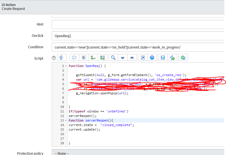

I have UI Action "Create Request" as related link on Interaction form. My requirement is to open a request on click of UI Actio and also to close that interaction as well. The request is getting open but the state is not getting closed. Below is the script i have written:
Action name : ws_create_req
Show update: checked
Client: checked
Onclick: OpenReq()
Condition: current.state= ='new'||current.state=='work_in_progress'
Script:
function OpenReq()
current.state = "closed_complete";
current.update();
var url= 'com.glideapp.servicecatalog_cat_item_view.do?v=sysparam133192332';
g_navigation.openPopup(url);
The state is not getting set. PLease help me in this regard.
Thanks!

I implemented the solution for state not getting closed. It worked!
Below is the screenshot for reference:

current.state = "closed_complete"; doesn't seem correct , can you check backend value of close complete and set it accordingly, generally it should be integer
