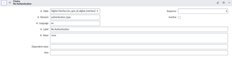

I've also noticed that the backend value for the No Authentication option is also set to 'none':
I was just wondering if anyone has come across a similar issue like this before and knows what I can do so that if the selects No on the authentication question in my catalogue item, then it sets the Authentication Type field on the new Digital Interface record to No Authentication
