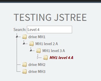

Another option is to use jsTree ( https://www.jstree.com/ ). The solution is similar to the previous solution provided by Lars but I found it easier to implement.
