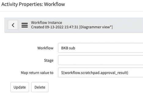

I can't tell from your screenshots and description if this is a workflow that you created in the Workflow Editor, or a flow that uses Flow Designer.  Here is an example in workflow.
The sub-flow is called in a Workflow Instance activity which is created by dragging the sub-flow name from the Workflows list onto the canvas.  This activity notes the name of the workflow (sub-flow) to execute, and a return value that can be mapped to a scratchpad variable

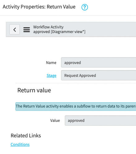

In the sub-flow, you have a Return Value activity for approved, and one for rejected on paths that come from the Approval activity  Approved and Rejected conditions.
Then back on the main workflow, the Workflow Instance activity leads to an If activity to determine if the return value is approved or rejected
answer = ifScript();
function ifScript() {
	if (workflow.scratchpad.approval_result == 'approved') {
		return 'yes';
		return 'no';
