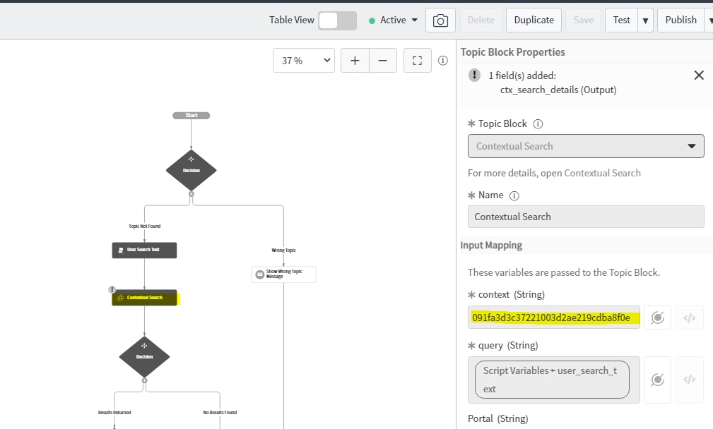

the context search is capable of returning both knowledge and catalog items.
Go to > Search context > copy or create on which has both knowledge and catalog item in searchers.
Then use that in topic block context search like below.

Hi Murali,
In the search context do I need to add catalog under Resource Configurations to make it search for catalogs also like the following screenshot :
Because I didn't had it configured, but now when I added it then it started showing the catalog items also in the search results.

yes that is correct.
