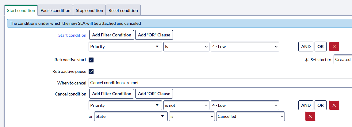

P4 Case resolution time.
Case has been Cancelled. Even though, the SLA definition for Cancel has been met the SLA on Case is still In Progress and running.
Case: P4 has been changed to P3, State has been changed to from New to Cancel.
SLA Definition: Priority is not 4 or State is Cancelled
I've reported that to SN Support but maybe someone had similar issues and has an idea on how to solve this problem?
(Apart from Repair SLAs)

What is you 'cancel' condition? If it triggers on 'state is not canceled' it won't stop when the start conditions are not met, unless you explicitly set it to that.
