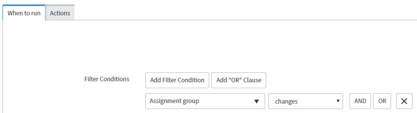

On my SLA Definition, I added in the restart condition, i have the below configured.

1) I can see the "Assignment group changes" mark as true on the new ticket. However, it is gone after save.
2) After ticket reassigned to another assignment group, the "Assignment group changes" mark as true again but no SLA started.

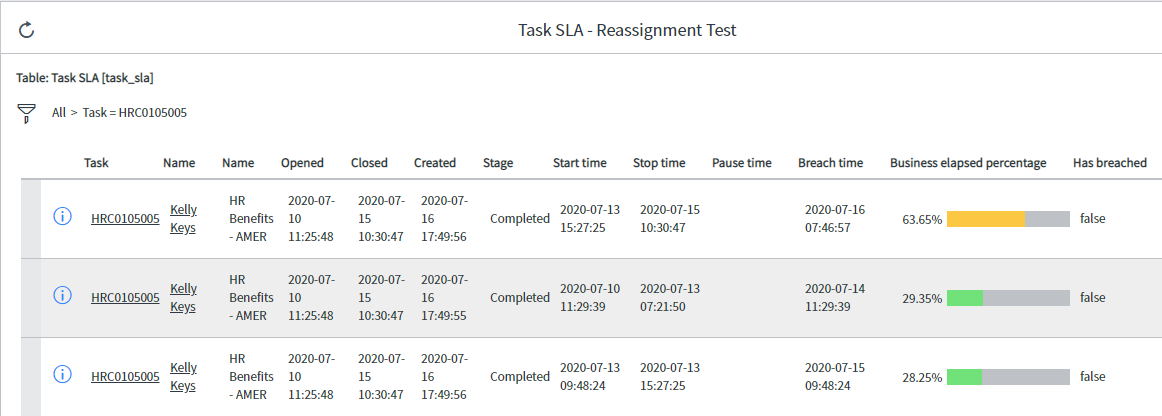

We are having a similar issue with reporting Task_SLA table.
in particular that the SLA restarts every time a case changes its case owner/assignment group, however, the report table only show us the most currently assigned case owner/assignment group (see below a screenshot). It makes it look like the last agent or group who worked on the case caused a breach in the SLA, but it actually was one of the previously assigned agent/groups who did that.
