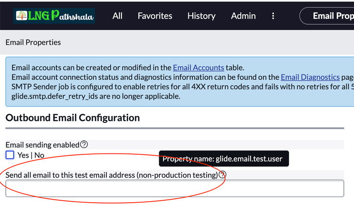

Generally, in development environments, emails are disabled, so some test email IDs might be mentioned.
Please check if any email IDs are listed here

Hi @Dr Atul G- LNG ,
Thanks, it's enabled in the production instance, but not active in the development and UAT environments.

So, in this case, the user will not receive any emails until these properties are enabled. Additionally, the email account needs to be set up in both the development and test environments.
