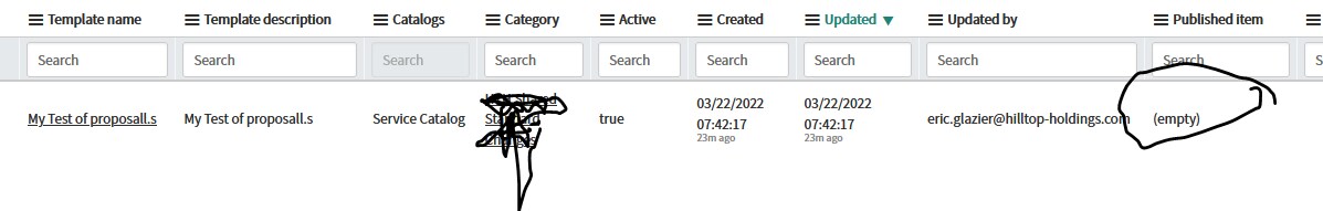

I'm not sure what I'm missing here. I have an issue where Approved Standard change templates keep having there updated date/by fields update when ever someone completes a new Standard Change using that template. But if i add a reference in the published_ref field, the updated date/by remains the same.
KB0787919 - states that reverting the (Generate Template On Approval) br to OOB will fix the issue and Publish the item.
I've verified that we didn't update the business rule.
When I compare this to my developer instance, the BR's are exactly he same as well.
I've also verified in both environments, that when I create a Standard Change using the any template but Updated Date and By are showing my name and the date/time i closed the change. And when the change templates published_ref field is not blank, both fields remain the same as when approved.
Any Reason why this would happen?

03-22-2022 06:05 AM
OK, went to my WF and changed the script. Took what was in my DEV instance and back out custom.

So reviewed a "Change Proposal" and the workflow completes as expected. This activity didn't error.
I saw in logs something about:
| com.glide.script.RhinoEcmaError: "rep" is not defined. plugin://com.glideapp.report/ui.jtemplates/sys_report_security.xml.6 : Line(1) column(0) ==> 1: rep.isPublished(); |
My Script includes are OOB, or so I'm thinking.
1)StdChangeUtilsSNC (screenshot) - no versions listed to this item
2)StdChangeUtils
var StdChangeUtils = Class.create();
StdChangeUtils.prototype = Object.extendsObject(StdChangeUtilsSNC, {
initialize: function(request, responseXML, gc) {
StdChangeUtilsSNC.prototype.initialize.call(this, request, responseXML, gc);
*Add customer changes below
type: 'StdChangeUtils'
Again, no versions here either and "Published Item" is still not populated on the template.
