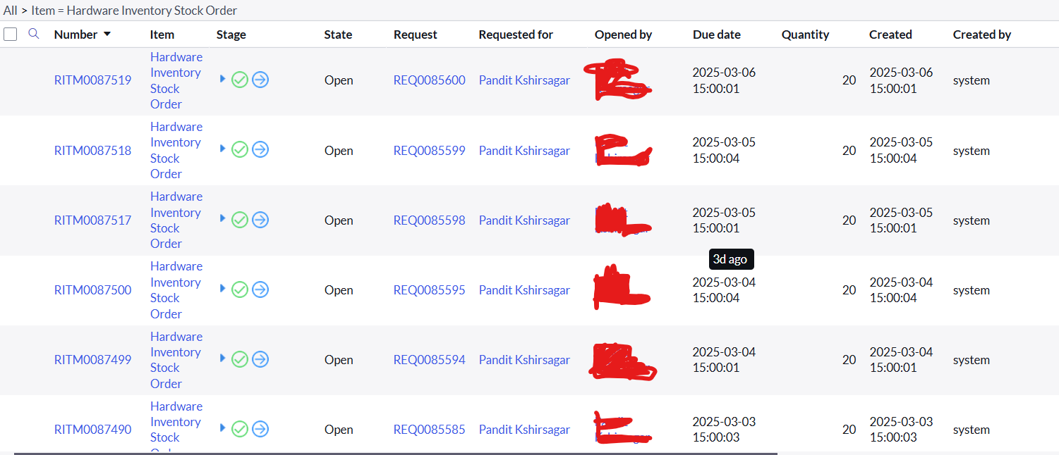

In Stock Rule Form, I have create a model name with threshold value as 15 and order size as 10. Also, I have activated the stock rule and aligned the stock rule runner job @ 3:00 PM on daily basis. I can see the email notification is triggered to stockroom manager and service request in the request item table (sc_req_item.LIST). However it create an another duplicate request on next day for the same model (Stock rule which was created) and also i verified whether pending deliver flag as "True" for the stock rule, it is true only. i could find the duplicate request has created on daily.
How to prevent the duplicate request for the same model threshold if already existing active ticket is on queue with the respective team?
